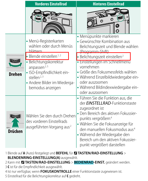

micaelo Posted June 26, 2021 Share #3 Posted June 26, 2021 Laut Handbuch geht's umgekehrt: Blende vorne, Zeit hinten. Welcome, dear visitor! As registered member you'd see an image here… Simply register for free here – We are always happy to welcome new members! Link to post Share on other sites Simply register for free here – We are always happy to welcome new members! ' data-webShareUrl='https://www.fuji-x-forum.de/topic/45175-schwierigkeiten-einstellung-x100v/?do=findComment&comment=1204064'>More sharing options...

micaelo Posted June 26, 2021 Share #6 Posted June 26, 2021 vor 4 Minuten schrieb Uwe Richter: Sollte man, je nach Gusto auch tauschen können. Ja, ich sehe gerade, es sollte doch so gehen wie gewünscht: Welcome, dear visitor! As registered member you'd see an image here… Simply register for free here – We are always happy to welcome new members! Link to post Share on other sites Simply register for free here – We are always happy to welcome new members! ' data-webShareUrl='https://www.fuji-x-forum.de/topic/45175-schwierigkeiten-einstellung-x100v/?do=findComment&comment=1204069'>More sharing options...
EchoKilo Posted June 26, 2021 Share #7 Posted June 26, 2021 Werbung (verschwindet nach Registrierung) Menü: Schraubenschlüssel / Tastenrad-Einstellung / Blendenring-Einstellung(A) = Befehl Alhambra 1 Link to post Share on other sites More sharing options...
Alhambra Posted June 26, 2021 Share #8 Posted June 26, 2021 Evtl. noch mal prüfen, ob auch tatsächlich "Befehl" ausgewählt ist? Siehe Fußnote 1 aus Beitrag #3. Möööp, zu langsam😀 Link to post Share on other sites More sharing options...
Maleikali Posted June 26, 2021 Author Share #9 Posted June 26, 2021 vor 4 Minuten schrieb EchoKilo: Menü: Schraubenschlüssel / Tastenrad-Einstellung / Blendenring-Einstellung(A) = Befehl Juppi! Das war es- Danke!! Link to post Share on other sites More sharing options...
